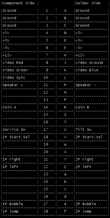

It came today and I fired it up, it uses a standard JAMMA pinout with a couple of extra things and stereo sound instead of mono.
