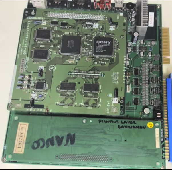

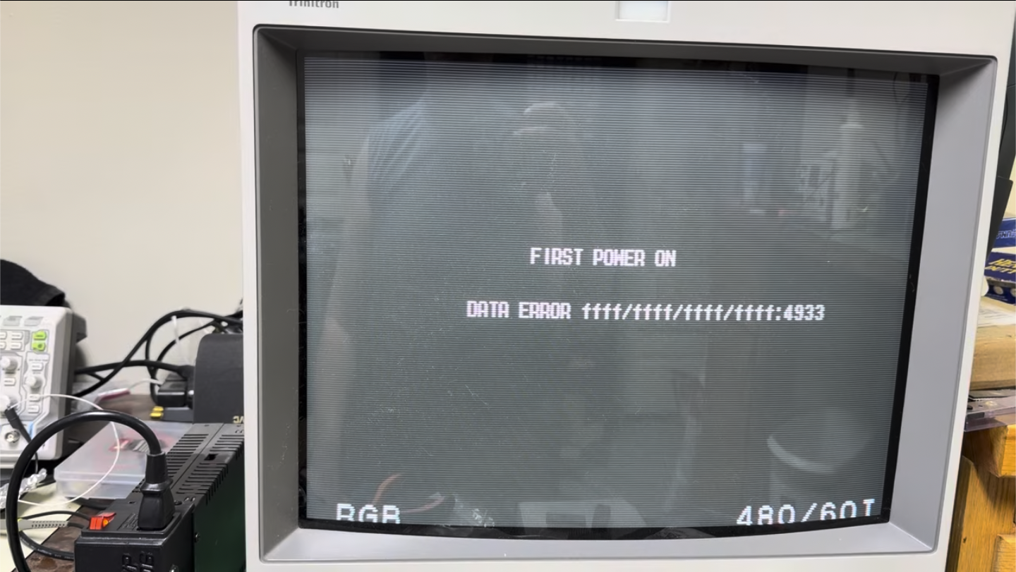

In for repair is a Namco System 12 boardset with the Arika game Fighting Layer.
At startup, the board would display the error “FIRST POWER ON – DATA ERROR ffff/ffff/ffff/ffff:4933”.

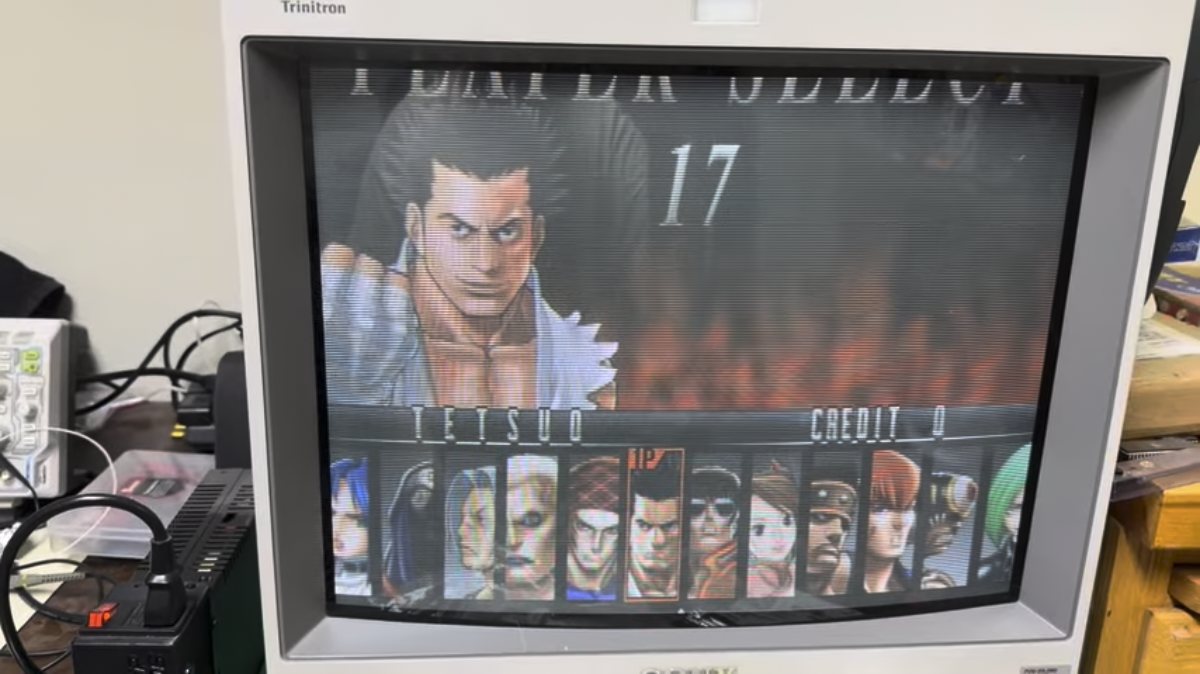

However, after displaying that error, the game would proceed to the title screen and play normally.

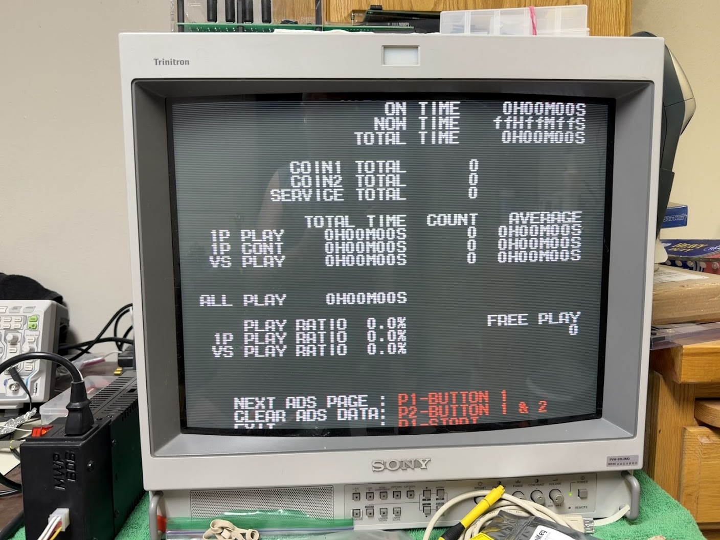

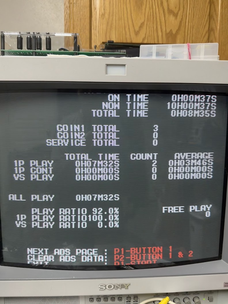

I assumed that the game was attempting to read corrupt bookkeeping info and stats from the onboard Atmel EEPROM chip located in the lower-right corner of the mainboard. Clearing the EEPROM contents in the Service Menu didn’t resolve the error though.
Notice how the “Now Time” counter in the upper-right corner didn’t reset to zeroes and shows all “ff”? We’ll be revisiting that shortly…

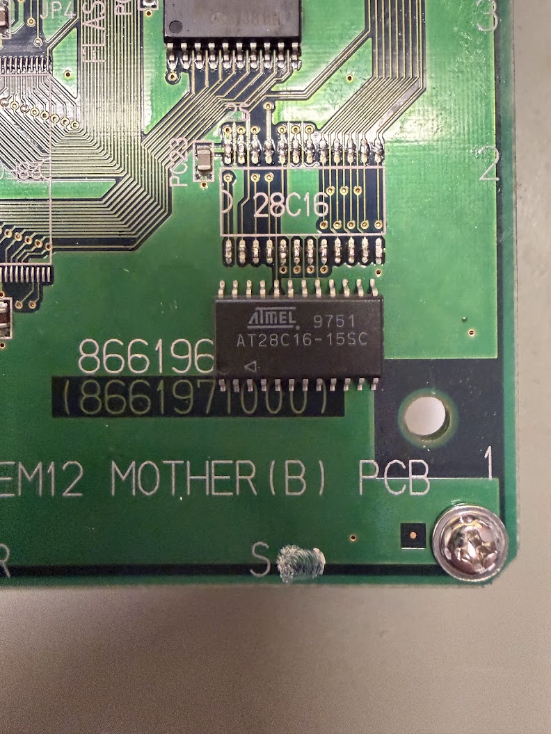

I’d been messaging online with Hammy – the resident Namco System 11/12 expert – and on his recommendation I swapped in a replacement Atmel AT28C16-15SC EEPROM.

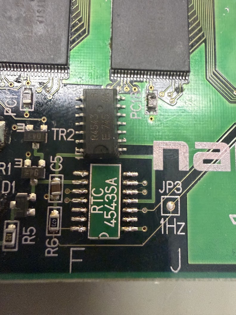

Unfortunately, the startup error and corrupt “Now Time” stayed the same. On Hammy’s recommendation, I next replaced the Epson R4543 RTC chip that’s adjacent to the battery in the lower middle edge of the mainboard.

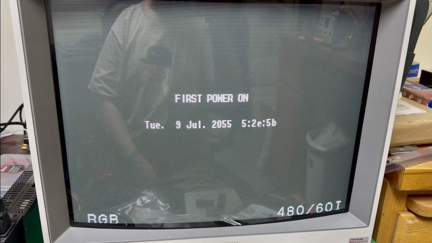

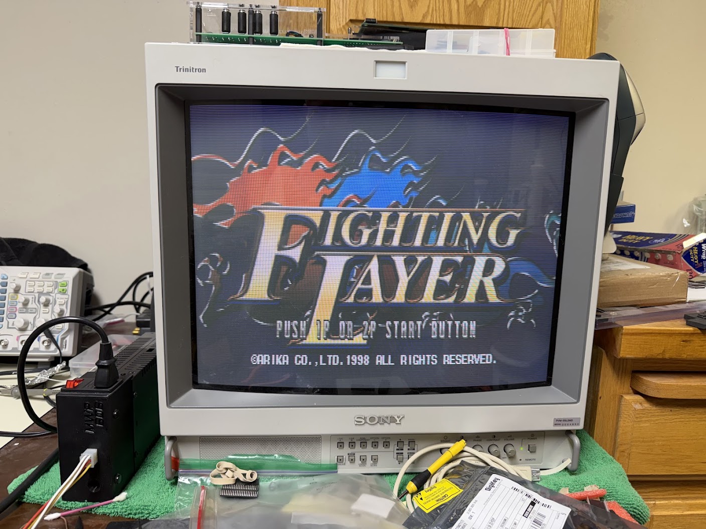

That was the culprit. This time when I powered on the board, it still said “FIRST POWER ON” but with a date far in the future rather than a DATA EROR.
The “Now Time” in the Service Menu was now ticking up from 00H00M00S and when I checked the board again the next day, it was still reading time correctly. The board also booted directly into the game without any error messages. I played a few rounds and confirmed that the bookkeeping info and stats were saving correctly into the EEPROM as well.
