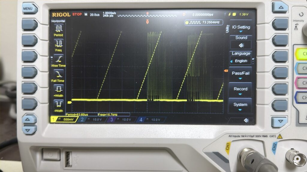

Many components need a clock signal, but I started by checking the clock input pin on the NEC V60 Main CPU first. The V60 Clock Input pin is Pin 13 and it showed the expected 16 mhz clock signal.
The Z80 Sound CPU clock input is Pin 6 and its signal looked awful.
Time to check the TTL logic chips that feed the clock signal to the Z80. The Z80 clock signal line is labeled “8MC” on the schematics.
And the schematics show that 8MC is output from Pin 7 on a 74LSACT244 TTL chip located at IC24.
I desoldered IC24 from the board and it tested bad out-of-circuit in my logic chip tester.

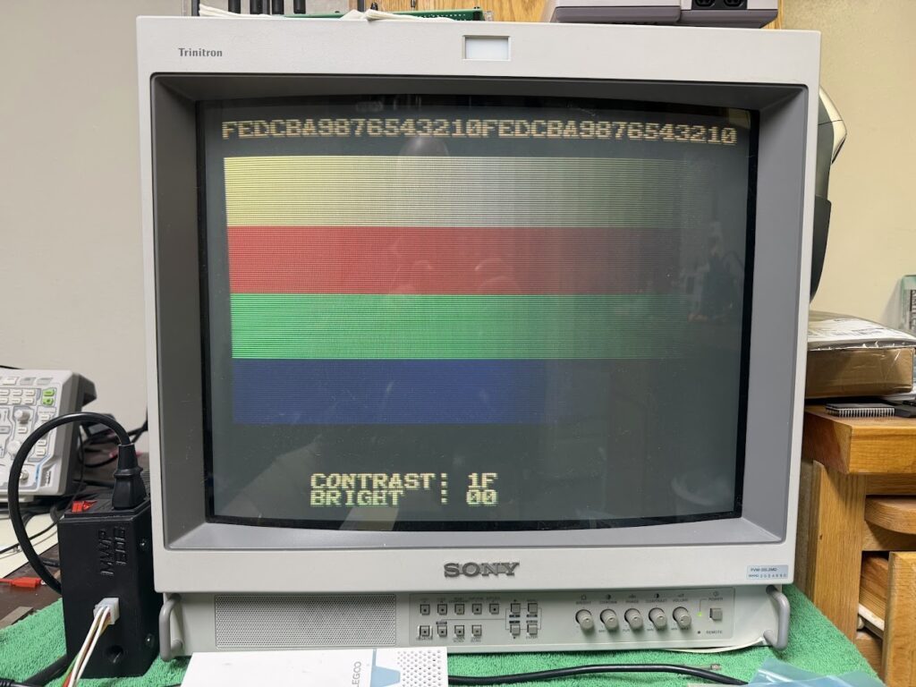

Unfortunately, the replacement part didn’t fix the board – it still hung with a black screen at boot. I started probing around the other TTL parts in the clock distribution circuits, when to my surprise the board suddenly sprung to life!
Sure, the sprites were garbled and there wasn’t any sound, but I was still pleased to see signs of life. This definitely hints at more problems in the clock distribution circuits. I found that probing IC23 is what would jumpstart the board, so I desoldered that part from the board, and sure enough it tested bad out of circuit.
