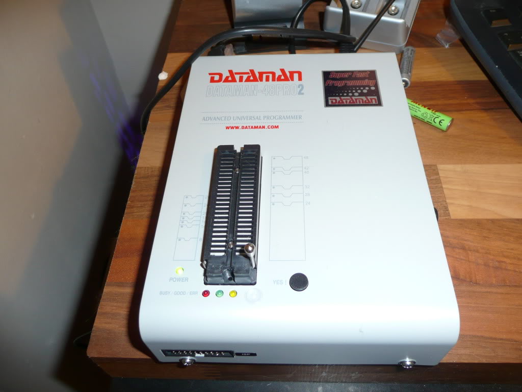

Dataman-48pro2
My new programmer arrived today.
This things does everything I could ever want including EPROM/EEPROM/Serial EEPROM/Flash/Nand Flash/NV RAM/PLD/MCU MPU/PROM. It also covers IC testing, RAM testing and some special devices that Ive never heard of such as clock synthesizers. It supports over 53000 devices and the software is updated every month.
