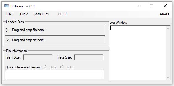

binman351
I’ve been working on this a bit recently, mainly to add a few things I wanted it to do but also did a rewrite of a few things which Caius has been bug testing for me.
-Moved the HEX view to the relevant menu’s
-It can now compare the two loaded files and it will give a match percentage output and say how many bytes are different.
-Can now create a new file within the program and can choose what to fill it with.
-Added auto concatenation depending on the EPROM selected. I recently found myself doubling up (or sometimes more) ROM files to fit into larger EPROM’s and just wanted a quick way of doing this.
There is probably a few other things added/different too.
As always it requires .NET to run
