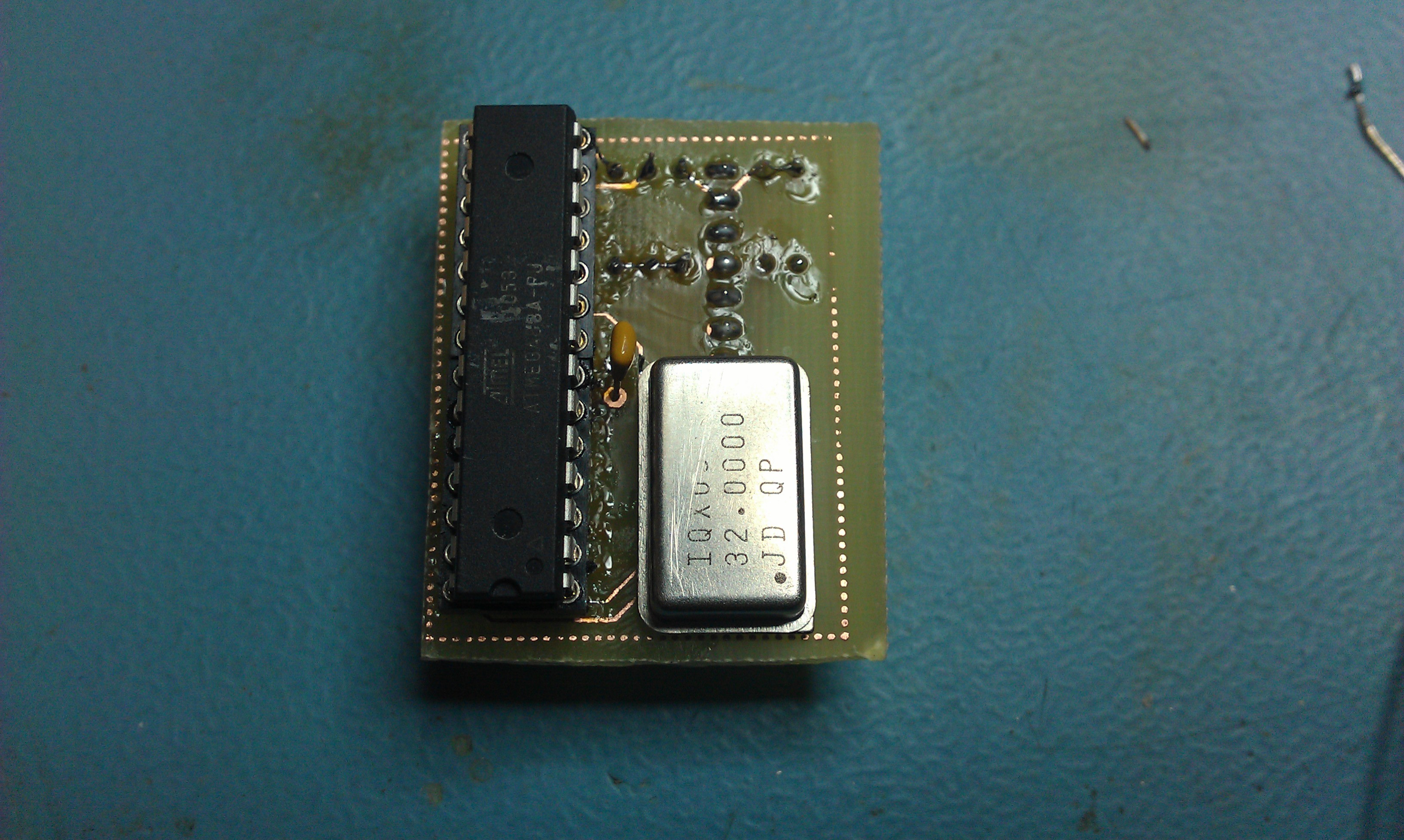

Today I decided to make my own SwinSID as I had the schematics and also had the parts laying about.
After a short time checking everything was going to the right places I fitted it into my C64 and fired it up.
As expected it works just fine.
The board still needs cut down to size. I didnt add the ground planes on this one due to some through hole issues.
Thanks to Swinkels for making the SwinSID software

    • Sure, what info do you want?
      What you using for your pla replacement? The pls100 chips I’ve got work well and the fpga alternative is also a really good device but can be pricey.
      If you send ne your email I can send you the files for the swinsid should you need them
