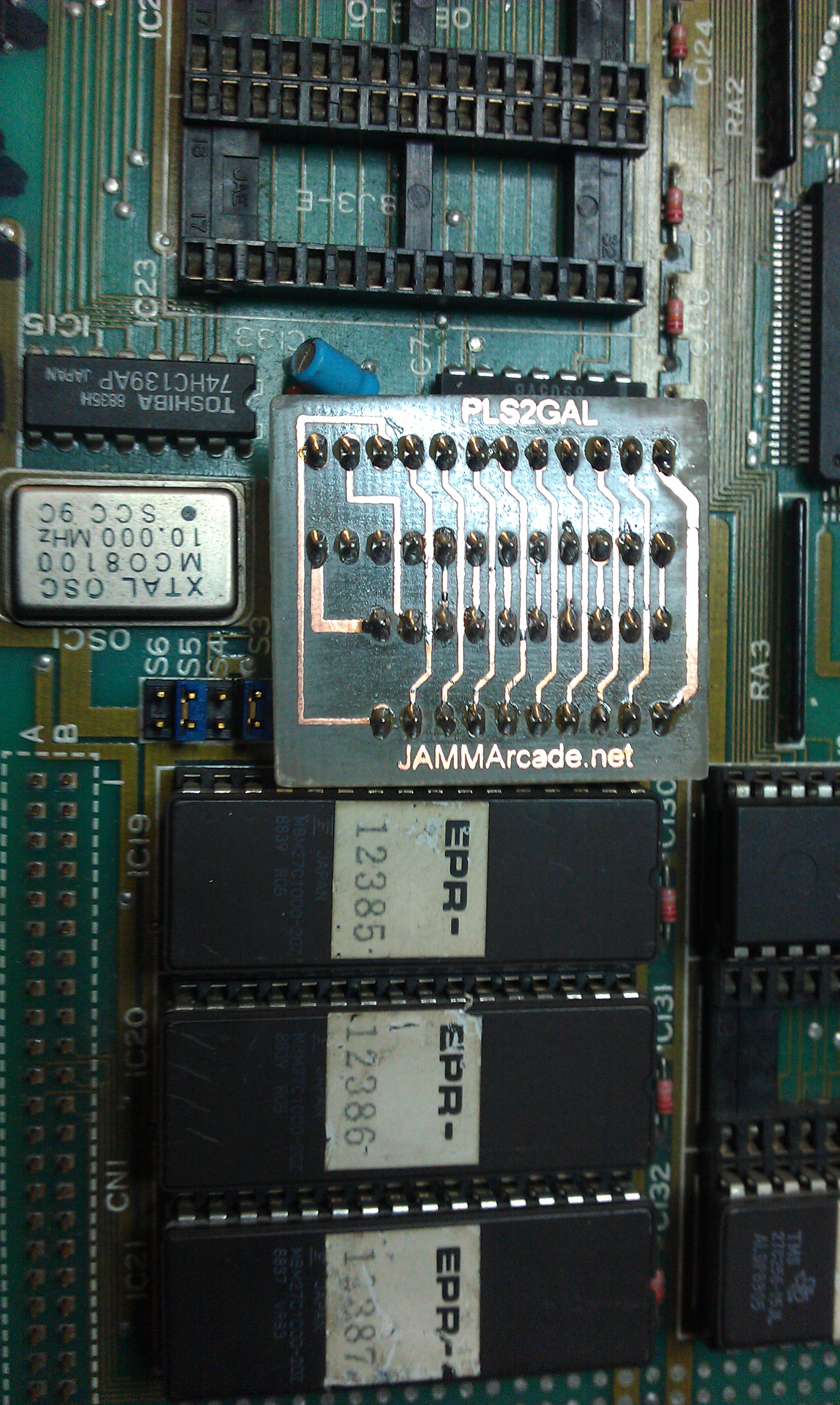

A little while back I made up an adapter for the PLS153 so I could use a GAL22V10 in its place providing the JED file was reworked.

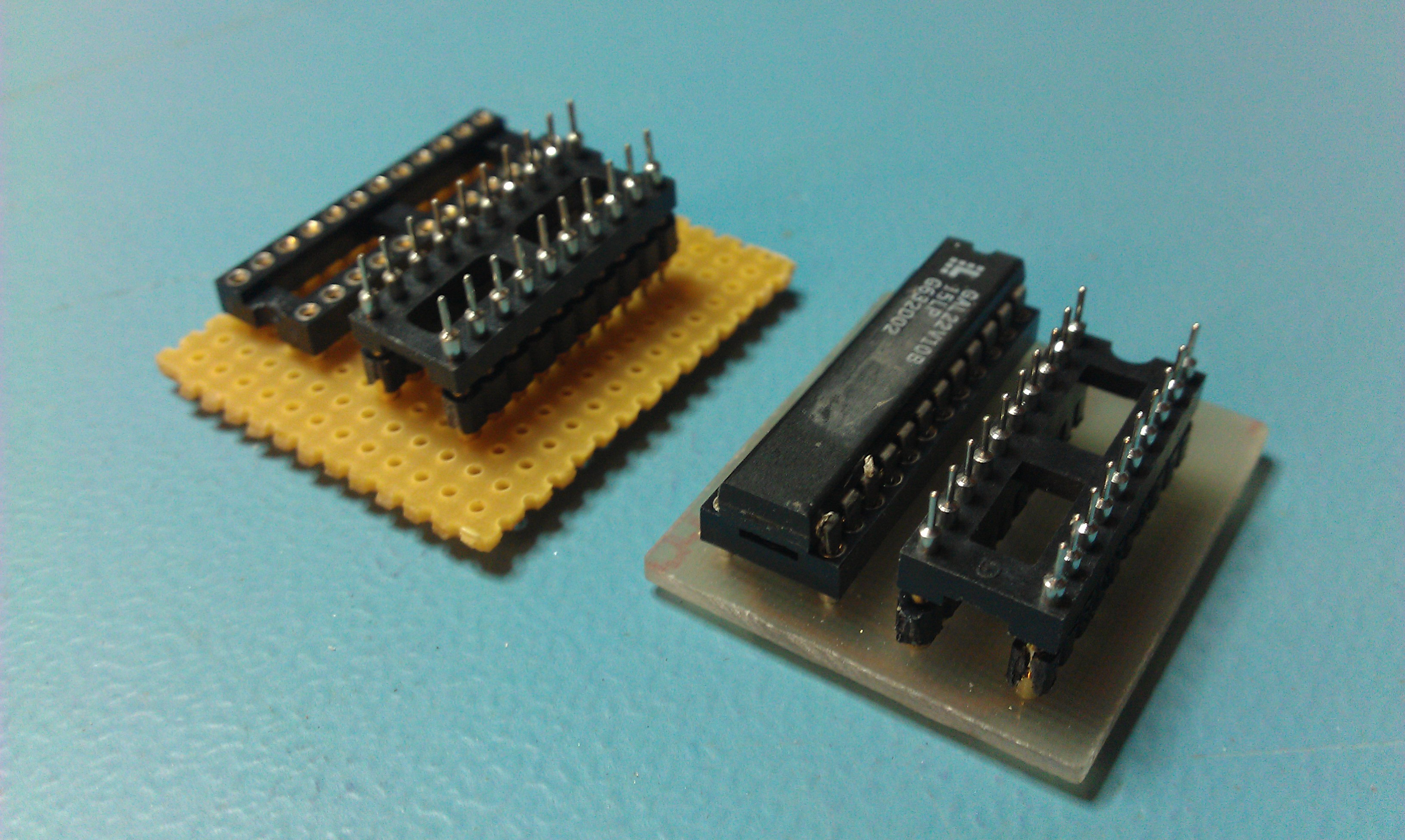

I made the adapter on veroboard but now I can do basic prototyping using copper clad boards I thought id make a proper one up.
The design only took 5 or so minutes in Eagle CAD and after a quick sanity check I printed and transferred it to a board.
And a little while later it was etched and time to drill this thing out.
I fitted sockets where needed and took a few comparison photos with the old proto one.
(or is it GAL2PLS?)

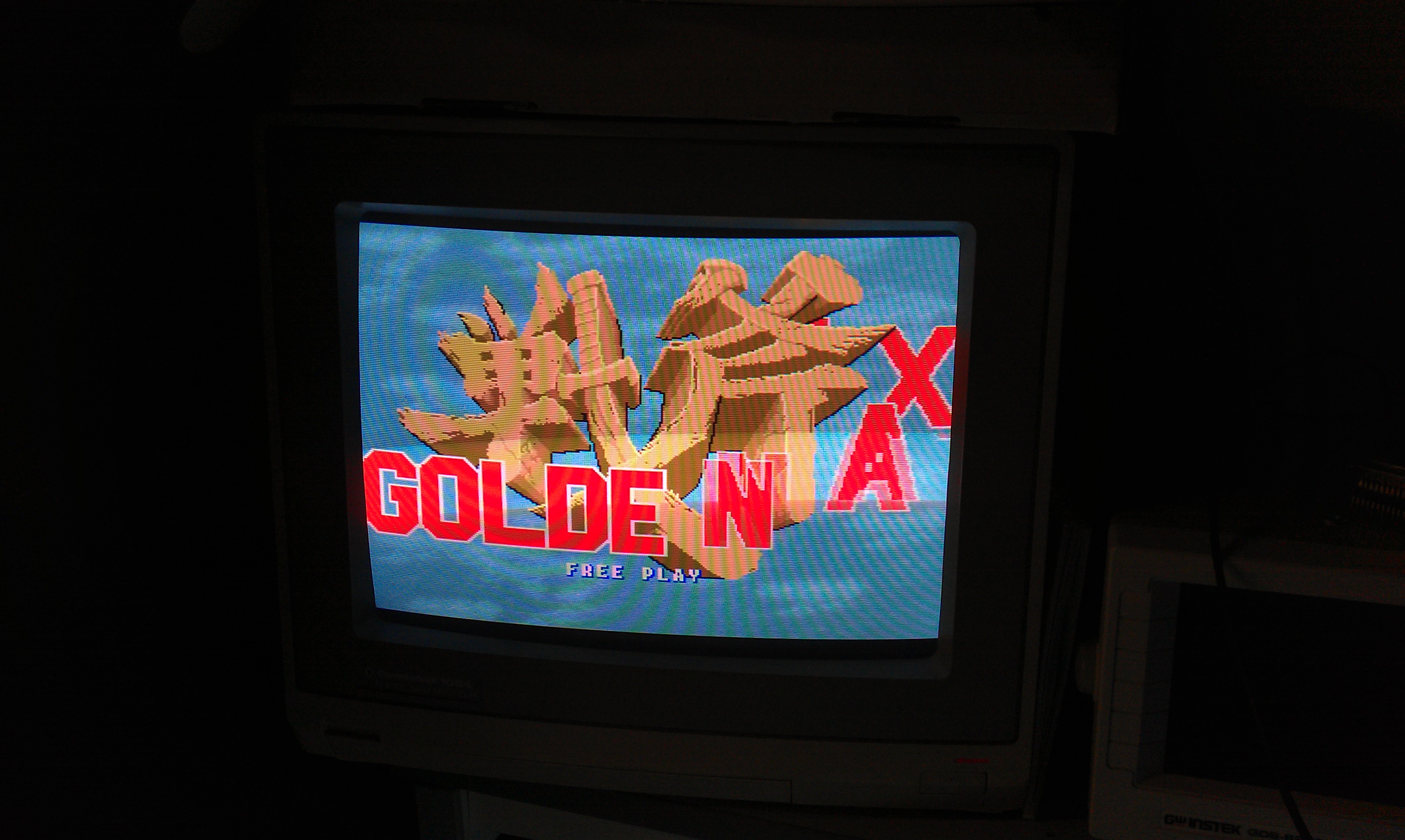

Time to run the game, works perfect. Im happy with this, I can now replace these parts reliably should I need to.
