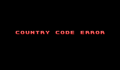

My first conversion was for the Japan version of 1944. When I got to this point and tested in an emulator, I received this message
If 1944 this area is different depending on the region so my simple program treated it as encrypted data resulting in it reading the region code from an incorrect address.
This area is located at address $C2. if the word is set to #$0000 this is the Japan region code. I think #$0002 is for USA but not sure what others are.
