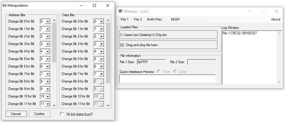

Philmurr from the UKVAC forums was asking about a program to manipulate the bit order for address and data lines of a ROM dump.
I had the idea for manipulating data lines in the past when I was dumping the Arcadia ROM’s from Unigame but I never followed through with it until now.
Anyway I have now added support for this to my BINman program.
bitmanip
Its fairly self explanatory I think and it has been tested by Philmurr on his Scramble ROM’s and I did some testing with Arcadia ROM’s too.
Latest version is 3.6.2
