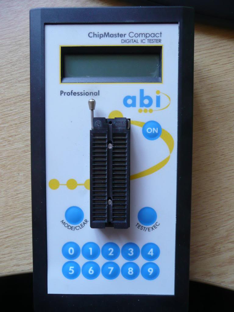

Ive been using this device for a while now but never really mentioned it.
Its a very useful device used for testing digital IC’s up to 40 pin for correct logical functioning. Any discrepancy results in a FAIL result and the fault information is displayed. It can execute various test loops including repeated test until pass, repeated test until fail and permanent loop test, the device can also search for unknown devices providing they are functional.
There is an RS232 port on the device which allows software to communicate with the Chipmaster and upload new software or create new truth tables of your own.
The device can test:
54/74 CMOS and TTL IC’s
RAMs
Interface/peripheral/microprocessor and LSI IC’s
Bring able to test logic, RAM and Z80s if a massive help to me when troubleshooting arcade PCB’s.

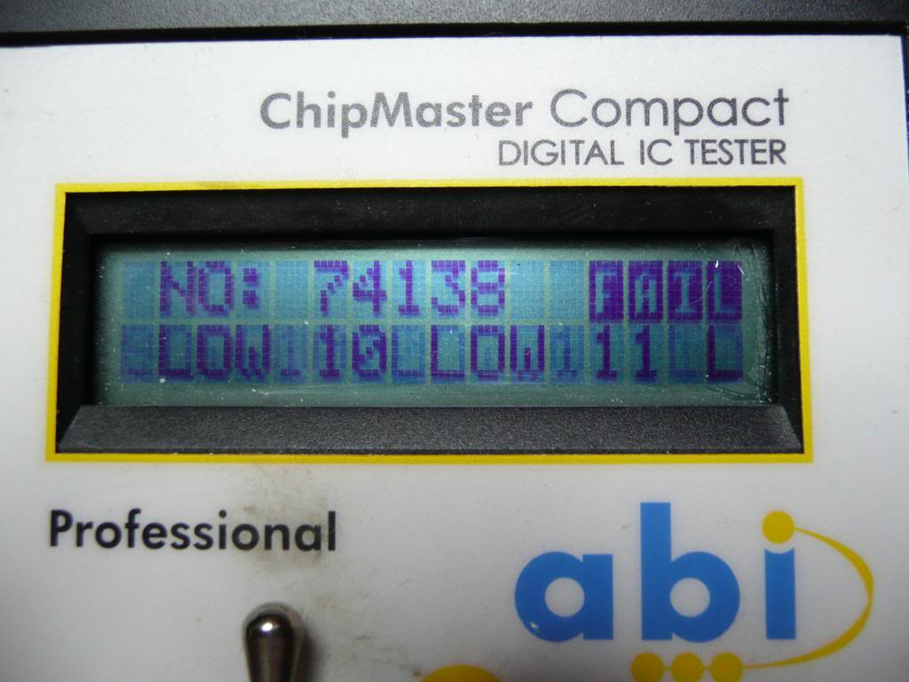

Firstly, the screen has a slow refresh and results in ghosting when it scrolls the fail information making it very hard to read properly.
