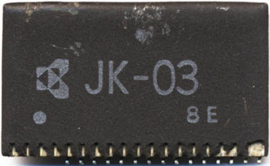

Some time ago I made a reproduction of the Jaleco ‘JK-03’ custom SIL used for inputs handling on some Mega System 1 PCBs but at that time I was not able to test it due to the lack of a proper PCB hence I asked for some volunteers.You can read the post here:
Today I can report the reproduction is fully working thanks to the test carried out from the user ‘Astro X’ of AP forums on his Saint Dragon PCB with missing ‘JK-03’ (actually an hack was installed as workaround) :
Thanks again to him for the feedback.

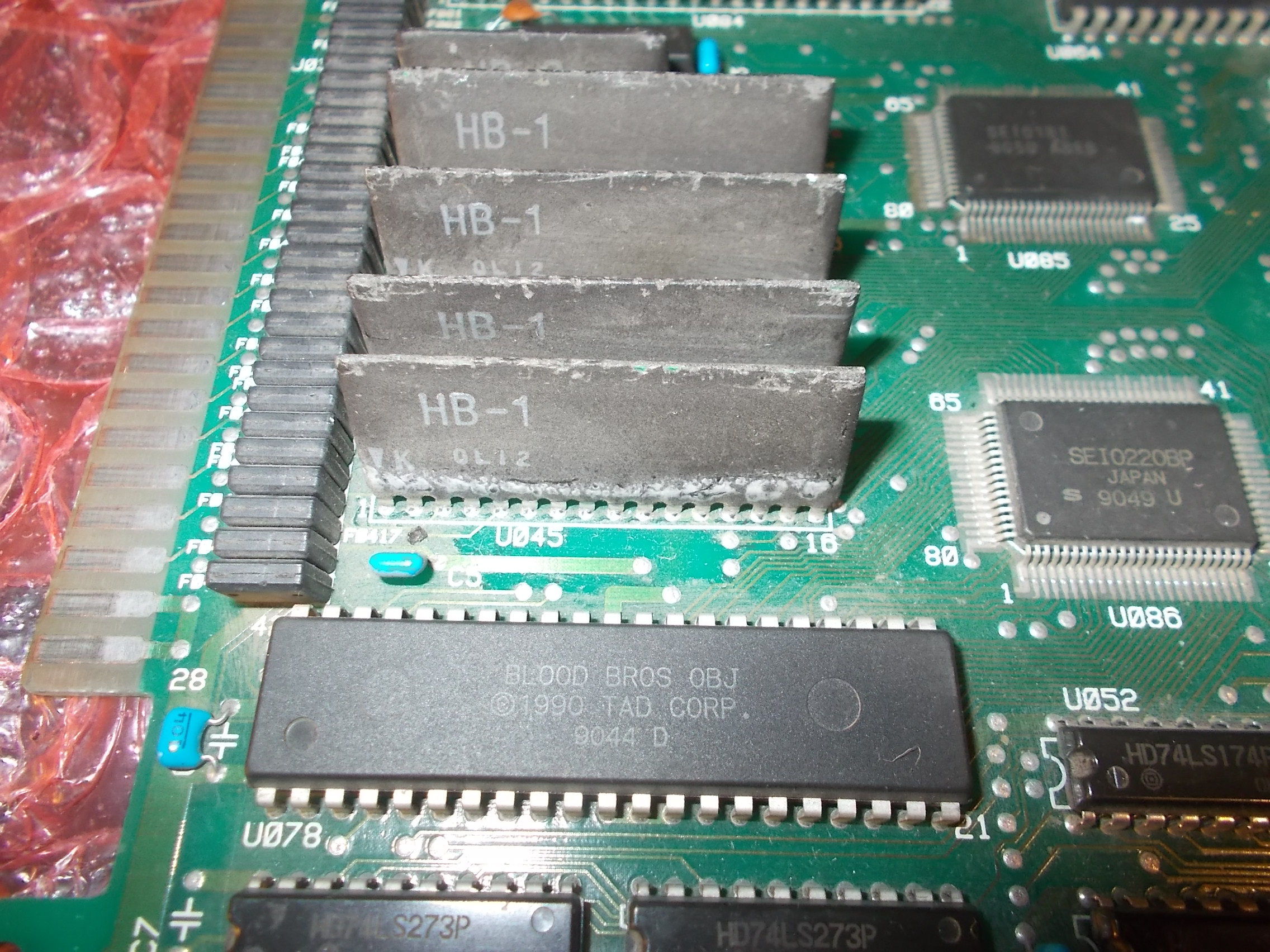

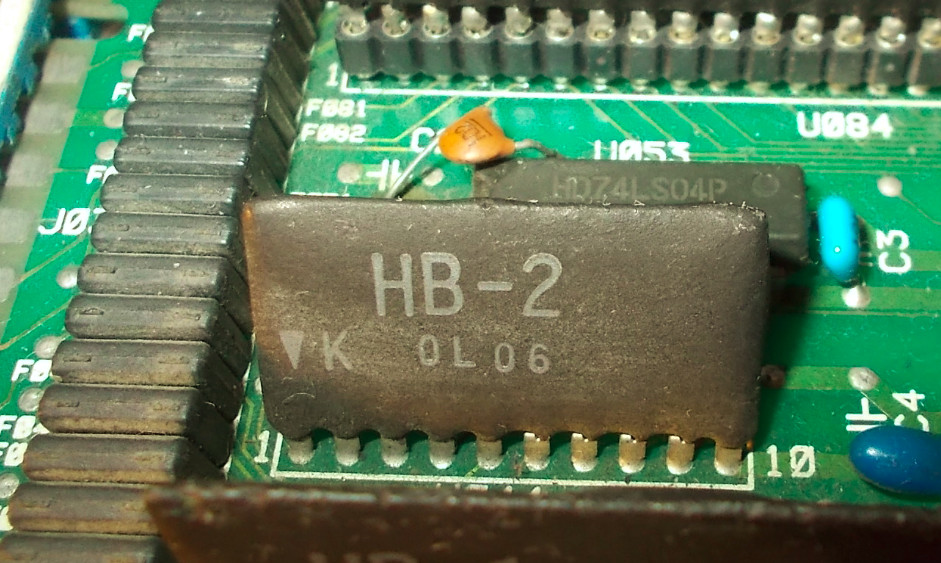

The ‘UEC-01’ and ‘UEC-02’ are two custom ICs you can find on most Seibu/TAD Corporation PCBs also marked as ‘HB-1’ and ‘HB-2’.They are ceramic modules in SIL/SIP package.Here’s how they looks like:

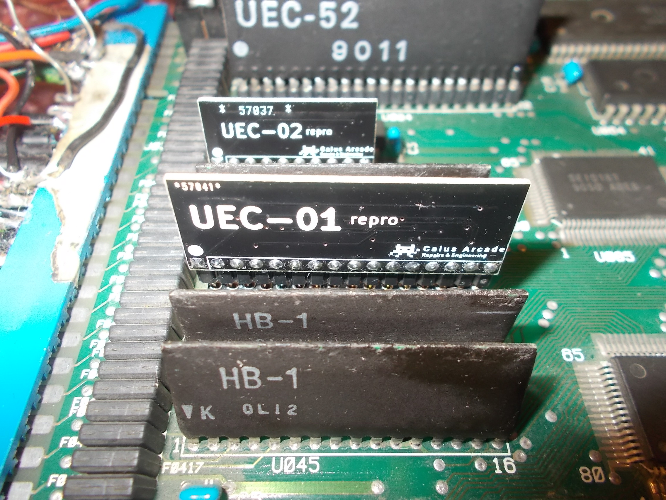

The first handles I/O, the latter drives coin counters/lockouts.Reproducing them was straightforward given the simplicity of their internal circuit so for sake of completeness I took into account also the ‘UEC-02’ although nowadays few people use coin counters:
Testing on a Blood Bros PCB :

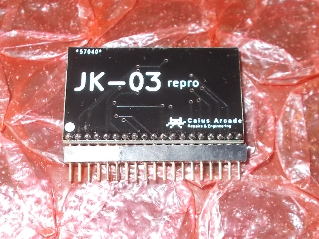

The ‘JK-03’ can be found, instead, on Jaleco MegaSystem1 hardware, it accomplishes the same function of the ‘UEC-01/HB-1’ handling the inputs.It comes in form of a SIL/SIP ceramic module as well (with different pin counting and pitch though)
Having no part to analyze I used some available schematics in order to reproduce it:
Due to the lack of a working PCB I could not test it hence volunteers are welcome!
