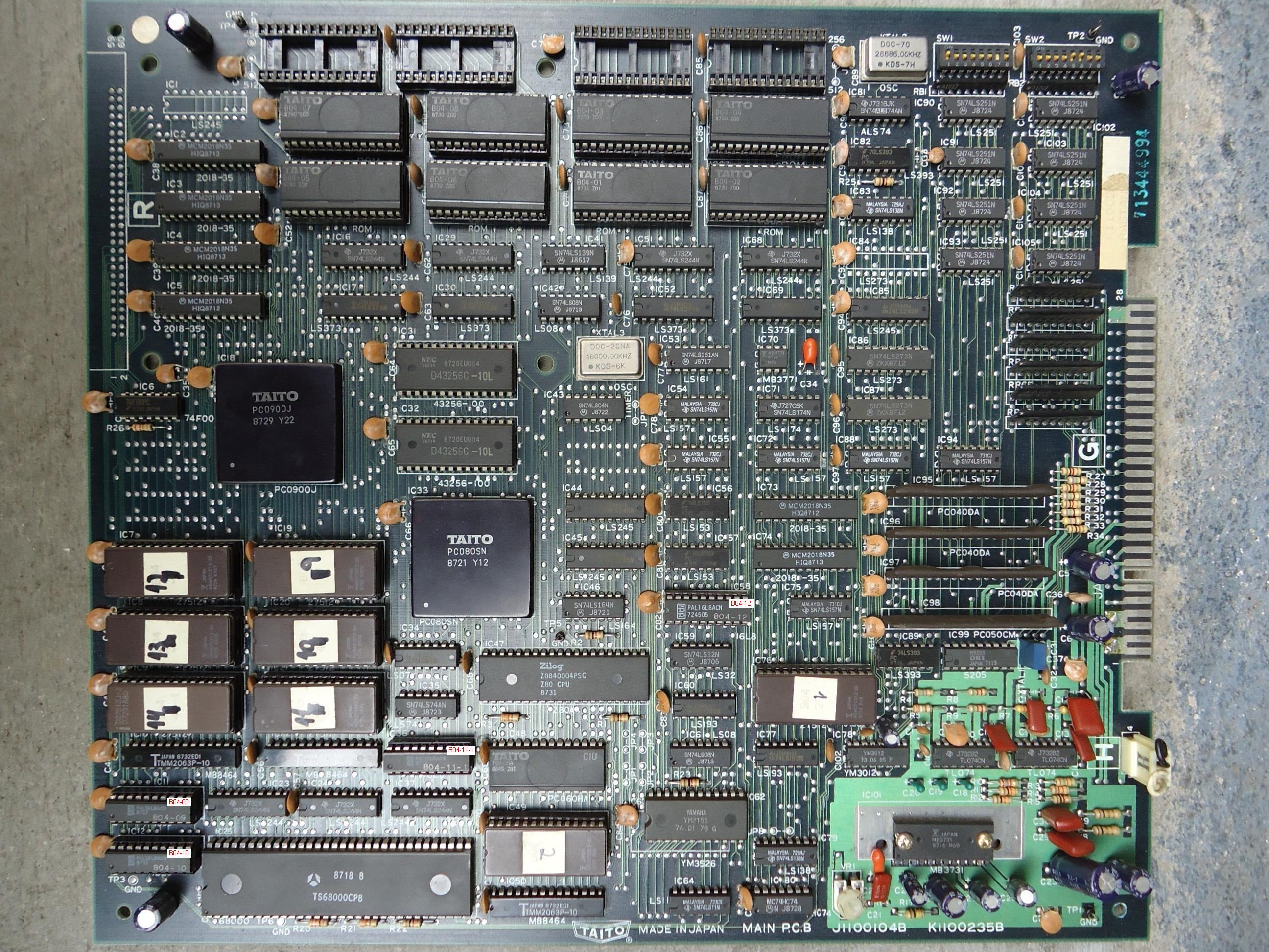

Rastan PAL dumps
Added more PAL dumps from Luiskiko.
These are the missing PAL’s from Rastan. Providing they work I should now have the full set.

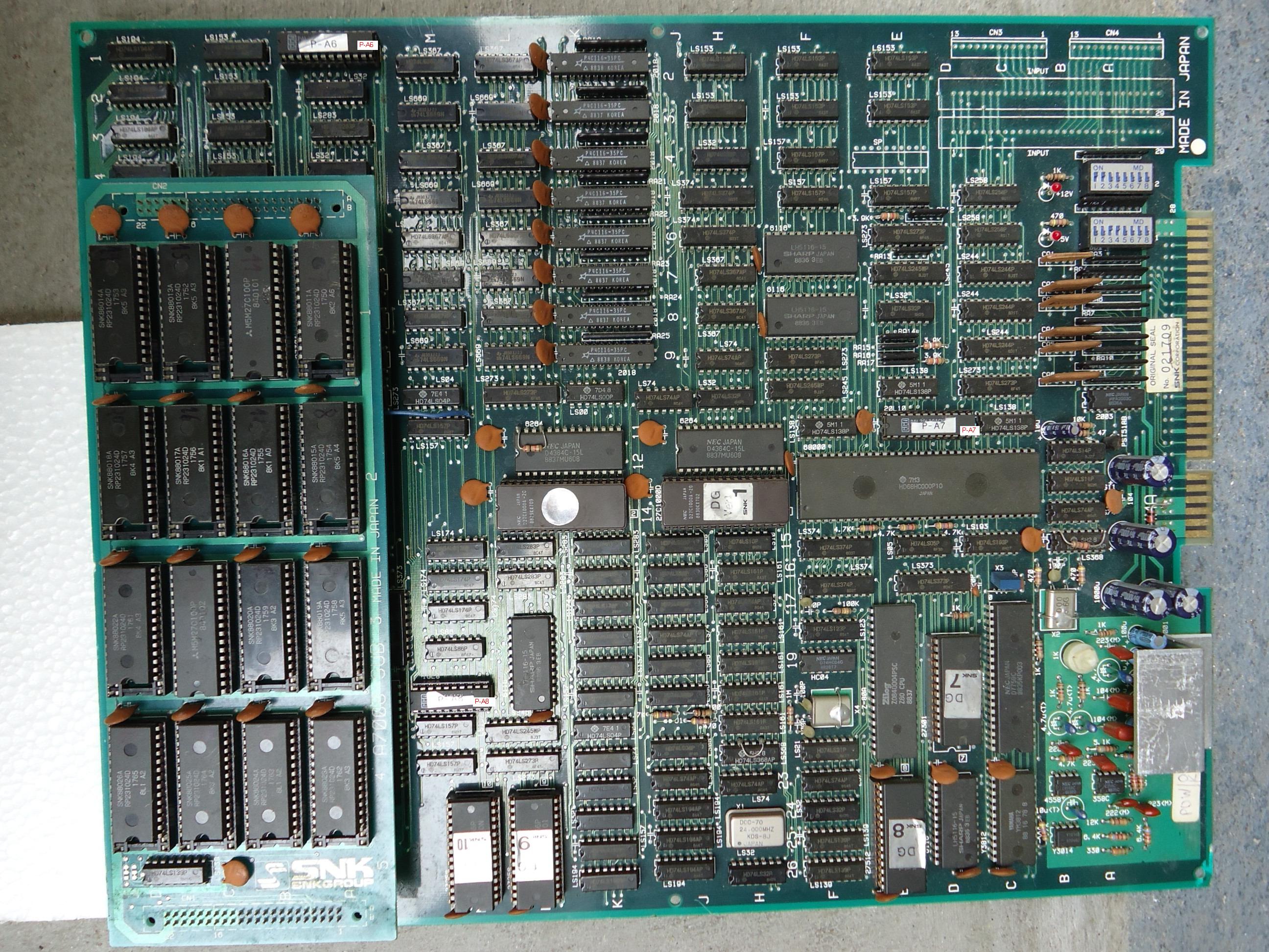

1943 repair log
Got a few boards today.
One of them is an original Capcom 1943 board.
Game had no sound at all.
After a quick look over the problem became apparent.
The EPROM for the sound was missing its GND leg. I replaced this with a 27c512 (data doubled up) for now as I seem to be out of 27c256 EPROM’s.
Game is fully working now.
