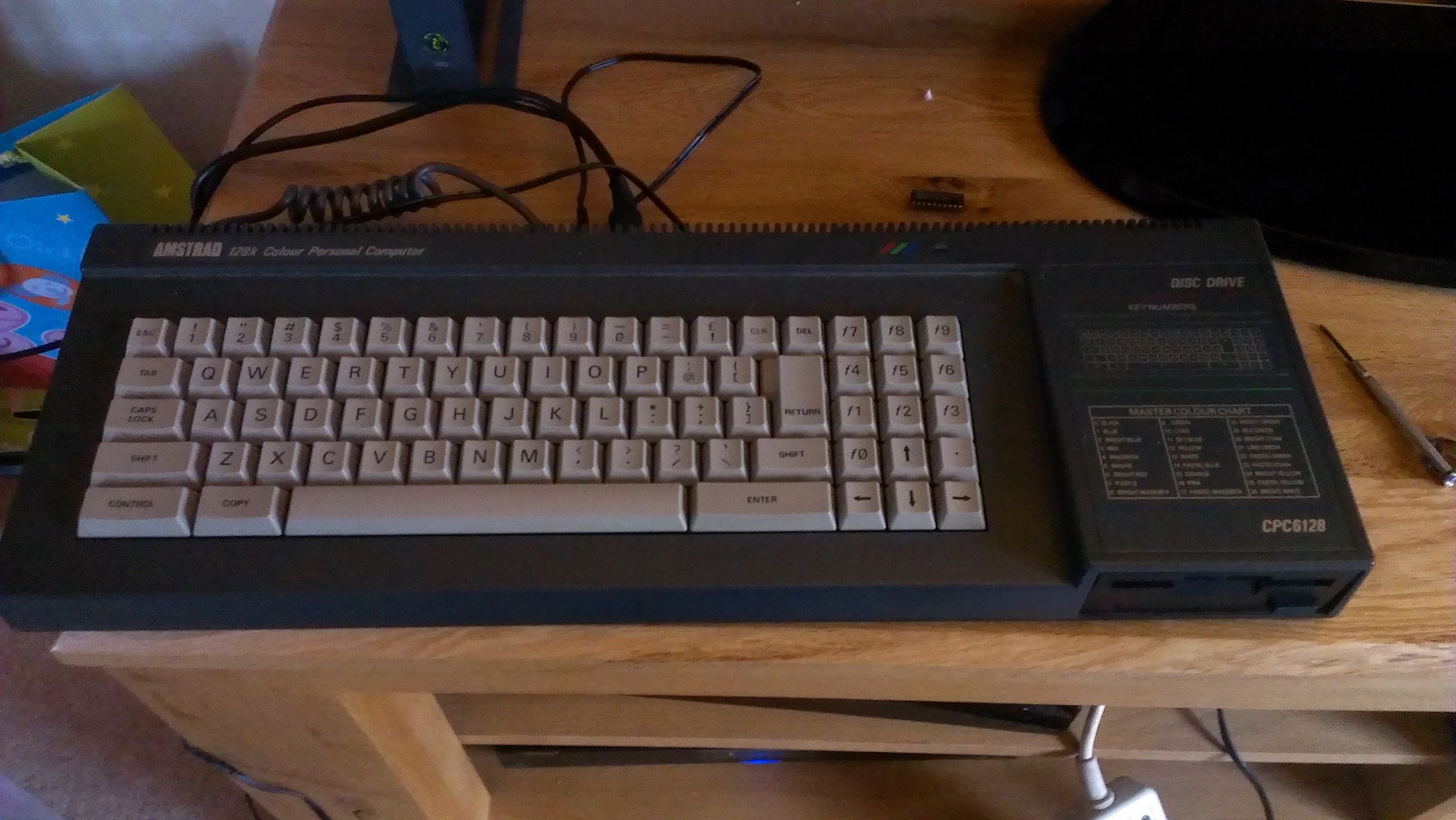

Meet my new addition to my retro collection, the Amstrad 6128.
Ive never owned an Amstrad computer before and I absolutely love it.
I had to change the drive belt but other than that it works great and came with a few discs too.
