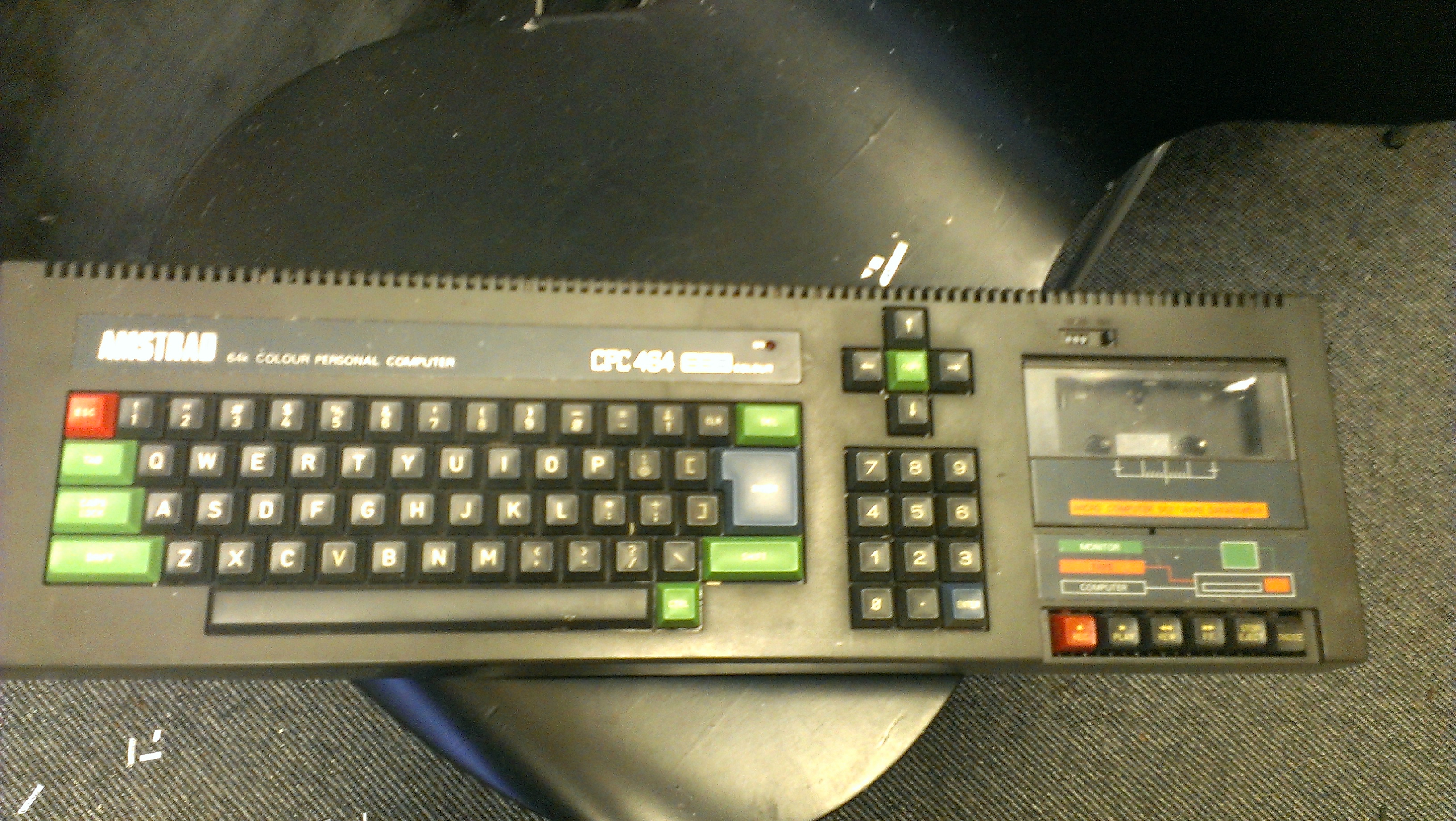

An Amstrad CPC 464. After being impressed with the 6128 I thought I would try out the 464. It was only a tenner so why not, it works too.

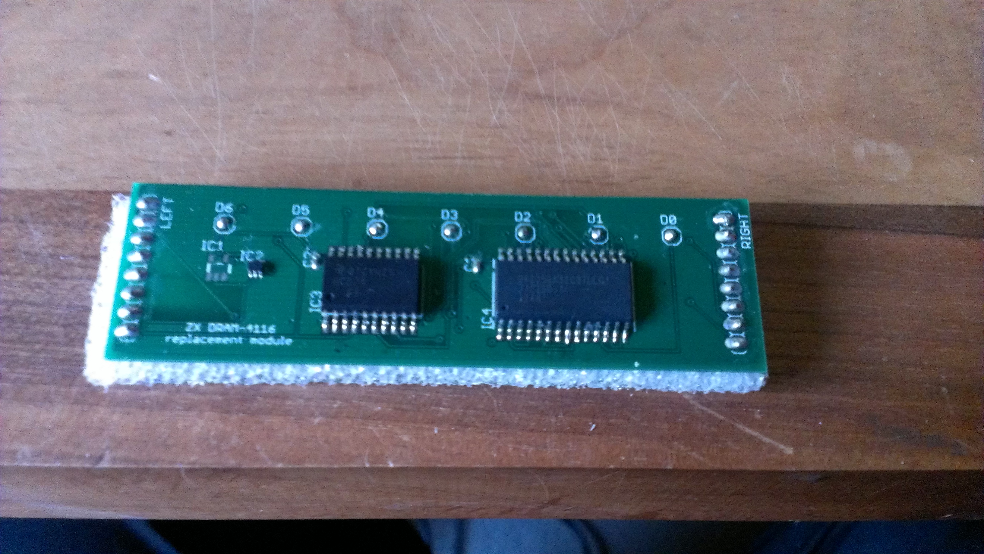

Last up is a rather nice little thing. Its a RAM replacement module for the ZX Spectrum so when those hard to find RAM chips go bad this modern day solution can fill the gap.
